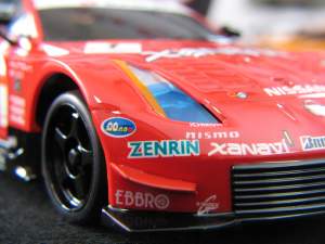

Here is the gt i bought from dan who used to race at south valley hobby.  It was uber...dirty like... never been cleaned...ever.  It took me a couple of hours to clean it up but here is how it looks now.  I had to get a new center diff cup cause it had slotted out, and the body posts were destroyed but hopefully the engine fires right up, that will be the test tonight.  Take a look at the diff gears and how they align with the bell gears they don't line right up and one of the gears is a little chewed up.  Is the alignment normal and if not what can i do?  any other suggestions.  how does the ferrari body look, i bought it clear and dressed it up.  I thought i did an ok job

I purchased mine used and it came the same way (all dirty).   I cleaned it up as well.    From looking at the pics the car looks in great shape.  did it come with the new ferrari body?
from what I can see everything looks to be in good shape.

it did not come with the body and i did the paint and decal work looks pretty good doesn't it

Ben nice job on the cleaning and painting, looks great!!
For the mesh on the clutch bell and spur gears you will want to move that bell forward a bit. It will work as is but would be better meshed correctly. Most important is the mesh between the gears. The old paper trick works great but I like to set mine by feel. You want just a little bit of space between the gears (like a 64th of an inch).
