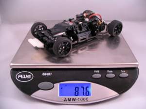

now for the finished weight of 87.6 grams,  that right .3 grams lighter than stock, in full race trim.  flex
Notes:  I have tested a bit using my small track at home,   the car handles very well and rotates around the corners nicely.  I'll have to get it on a big track and see how the tires and the rest of the setup are for that track.  at home on the HFAY Time Trial track # 1 I was able to run the 50 laps in 3:56.18 after a couple of tries. In comparision I ran a best time of 3:53.14 with my MR-02 that I have been racing for years.  I'm sure I can beat that time with a few more runs with the MR-03.   So for now I'd say it's a worthy competitor.
best lap times:  MR-02: (4.36)   MR-03: (4.41)
