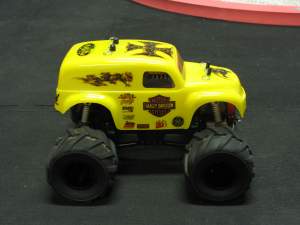

here are some pictures of the final product,   it's a nice clean install with.   I didn't have to change the geometry of the rear spring by racing the mount.   As you can see from the pics everything went in nicely.
click on the first image to go to the gallery for full size pictures.
