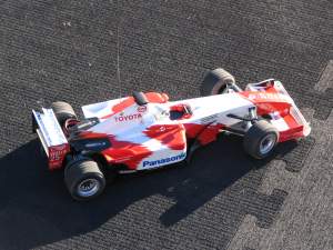

« Reply #6: April 09, 2008, 09:59:16 AM »
I converted my F1 diff last night.   I used the 54 spur with the 12 pinion.   I like this setup.
For the swap you need to change the plates to the MR-02 plates as the stock Kyosho ones are to large a diameter.  for the F1 diff no sanding was required.  also you install the spur backwards moving the gear side closer to the mount.  this allows you to push the pinion all the way on the motor and still have the pinion and spur line up.
it might be different with your Atomic diff ??
I also fixed the tweek so now I have very consisitant steering for left and right.  Cool
I went to some 1 degree Knuckles, and some stiffer front springs.
