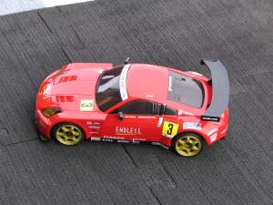

Our club does not use the chase mode function and most of us are using the KT-18 transmitter. I figured out a way to get full power to the motor which is normally limited to 70% ,by default, with this transmitter. I noticed the board allows full power in reverse. So buy swapping the polarity on the motor wires and reversing the radio's throttle function the motor runs full power forward (which was reverse) . Used the ICS to turn off the delay to what was normally the reverse function and all is fast forward now. Now there is some down sides like the brake function is no more but really never used it at our club.
Anyone else tried this?
